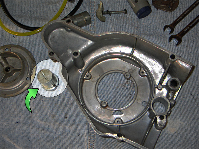

Replacing the friction discs is as straight forward as it seems. But you will need to do a couple of maintenance steps before replacing the discs.
On the left side of the engine you have a clutch adjustment. It is basically a threaded cam. You will find that the grease inside has gone hard and maybe the reason the clutch is "slipping" because the cam is not retreating back fully when you release the clutch lever. So:
1.) Clean the clutch adjuster threaded cam assembly and relube with fresh grease. Synthetic grease I think is best, and don't grease to excess.
2.) The clutch plates are tarnished with burnt on oil residue. Find a container that will hold the plates deep enough to submerge them. Place them in the container and fill with very hot water. Add 1 pint of chrome cleaner, let sit for about 10 minutes. With gloves, remove the plates and scrub the remaining residue off with steel wool or Brillo pad. Dry with a paper towel.
3.) Flat sand each plate, both sides, with 180 grit sandpaper to renew the surface.
4.) When reassembling the plates and new friction discs, make sure the thick plate goes into the basket 1st. The remaining plates are all the same thickness.
5.) The clutch springs should be OK.
6.) Re-adjust the clutch cam and take up the slack at the clutch handle adjuster.
While you have that side of the engine apart, clean the uptake filter on the oil pump.

There are more adjustments to the clutch mechanism than meets the eye. Here on the forum we have tips on how to adjust the clutch. The clutch might seem to be holding in the lower gears because the engine is allowed more revolutions per wheel revolution. But when the higher gears are engaged the engine encounters more resistance which puts much more stress on the clutch. This is much more likely the result of a clutch that has fallen out of adjustment. :) First I highly recommend that you adjust the clutch back and forth to get a feel for adjusting it and to check the operation. If you put in a new clutch and it still doesn't work like new you might get frustrated. =]
Here is the thread I have breaking down every single little part. The clutch adjustment drum is the key here... that is once you make sure the clutch cable at the handlebar isn't too tight (in your case of clutch slipping).
http://www.fourwheelforum.com/showthread.php?t=103
Clutch drum thing that adjusts the clutch rod throw with just a tiny twist with a screwdriver.
