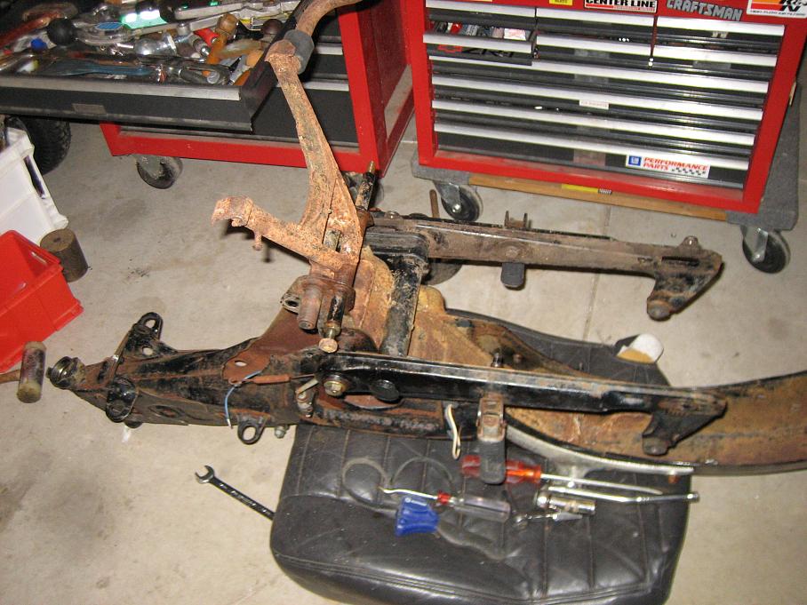

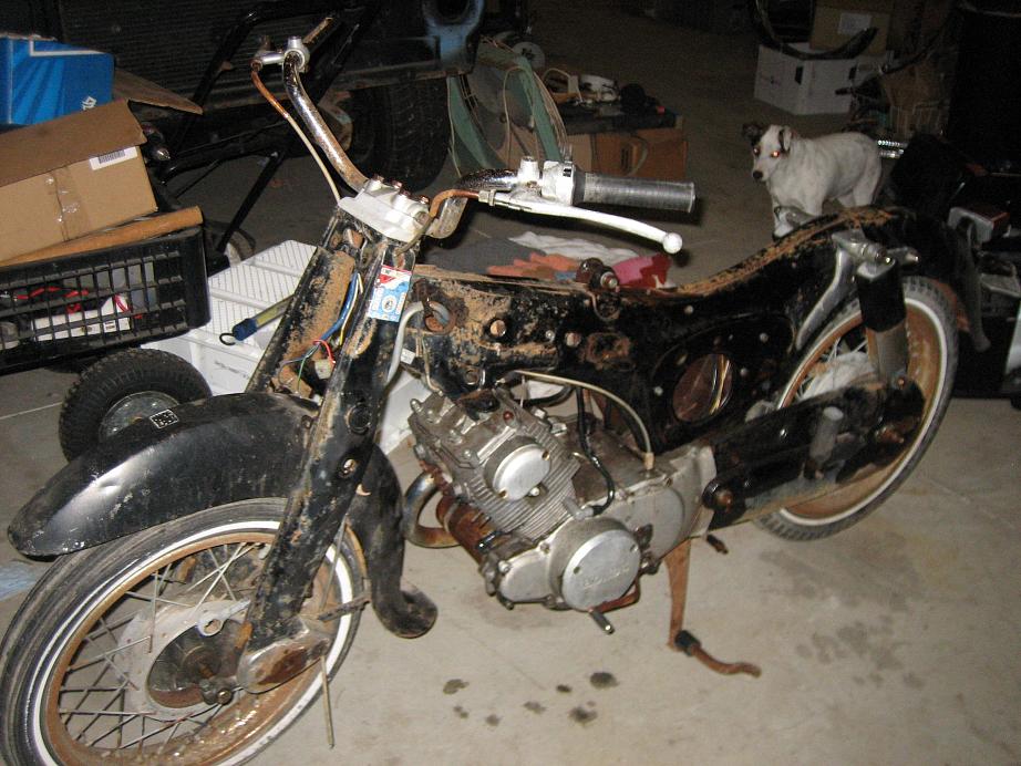

Here is a shot of the body, as soon as the engine is clean I will start on the body. Its still cold here in Michigan so I have a few days to get my paint work ready. My plan is to have all parts ready for primer by the end of March for paint sometime in May.
The bike had a 1981 plate from Kansas. When doing the tear down I couldnt find any issue other than a bare wire to the coil. ? My question is that what took the bike off the street? Easy fix if so. The engine looks nice inside, I dont plan to split the case for inspection and repairs. I will pull the head and jug to lap the valves, check the rings, and blast the outside of each.
Ahh that damn Ebay/ Paypal and their fees! Hopefully the clutch cable mechanism where the little drum rotates and pushed the clutch basket rod is in good shape. Once those get worn or damaged these bikes would just be parked as people generally wouldn't pay to have a shop fix them. At least the handlebars aren't bent and you have the levers and perches in good shape. These parts seem to be the hard ones to find good original replacements for.
Yes the handle bars are nice, they need rechromed but thats it. It really is a nice project bike, most of the hard to find stuff was on the bike when I got it. I was just inspecting the clutch push rod a short time ago. I was cleaning the chain case and put some oil on the push rod, it seems to work properly. I had planned to pull the clutch basket apart to check the plates. Maybe pull the oil pump for inspection also. The engine looks great inside but I have found its good to check things over after years of sitting.
