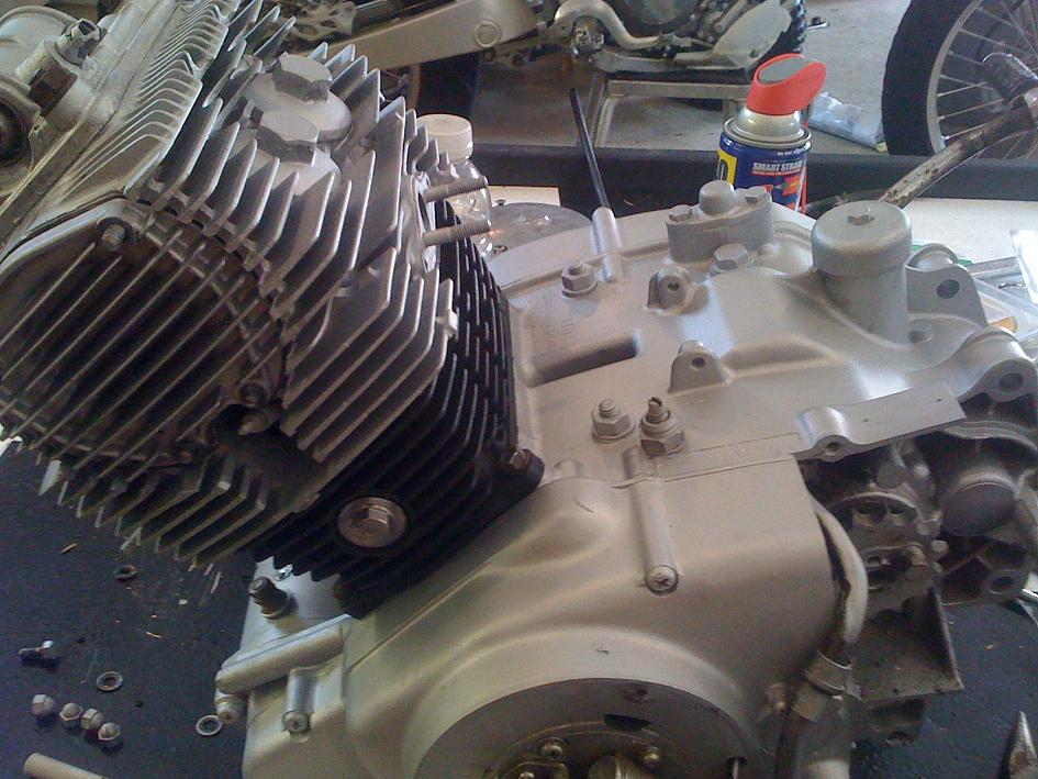

The breather for the whole engine is the plate that is bolted to the top of the cylinder head. There is a thick gasket under it so if you remove it be VERY careful if you want to re-use it. It might be damaged from deteriorating. I doubt it though. There is a hose that attaches to it so you might want to check that out.
I'm curious as to the area at which the oil is coming out of. That's not a good thing. Check the breather of course. I would expect the oil to come out of one of the seals before a gasket area. I hope there isn't a crack somewhere! If the breather isn't malfunctioning then it sounds like a bigger problem. : /
Post up a picture!
Hey glad to see some pictures! I kinda had a good idea of what you were saying but it's hard to imagine the oil pooling up in that area... because where it's pooling up: that gap should be clear! It should be able to go all the way through the bottom of that recessed area and drop on the ground. I'm thinking you overfilled it. The oil breather is right on top of the cylinder head as I mentioned before. Well check where the hose goes from that breather. It might be dripping the oil right down on the top of the engine where you are seeing it.
So make sure and get some tools to run down in that area where the oil is pooling up. There is something letting the oil drip onto the top of the crankcase right there. It can't be broken right in that area or coming up from inside there but it should be nice and clean/clear there so the oil goes right through.
Lemme know what you find.

Sorry to jump in so late... just found this site today. This is great.
I'm wondering if it's not from the breather on the back side of the cases on a later model CA. I just finished restoring my motor and notice just from kicking it over by hand that there seems to be an excessive amount of air or something blowing out that breather.
Assuming I did this right I tried to attach a photo... it is the cylinder shape thingy coming up out of the back of the case.
If that's not what causing your problem... I'm wondering if it's normal to have a any amount of air coming out of it. The service manual refers to it as a breather but it seems odd that it's a noticeable amount of air coming out
Are you sure it is oil that is pooling in the recess on top of the crank case.
At times, the recess gets dirty and blocks the drain hole in the bottom of the recess.
I have known this to happen and the recess can fill up with gas (petrol) if the carb overflows.
The gas then loosens the muck blocking the hole and the gas then drains through under the motor.
Juicemavin, It would seem that you have a mixed up motor.
From the picture you have crankcases from an early model with the breather on the crankcase above the gearbox and the top engine mount with the breather on it from the later model. It's not a problem, just letting you know.
Yep. Sam beat me to the punch. There was a change in engine design in 1964. Pre 64 you had a breather (like yours) on the top back of the engine case, and a solid cylinder head cover. After 64 the top case did not have a breather. Honda re engineered the breather into the cylinder head cover and ran a tube into the manifold insulator, which diverted the pressure into the intake manifold for reburn. It was the early stages of reducing emissions.
You will get lots of air from the cylinder head cover tube. It comes from the downward motions of the pistons.
So, depending if you have a 64 and after cylinder head assembly, you can attach a carb insulator from a post 64 engine and run a tube from the breather to the insulator. Or if it is a pre 64 engine plug the hole and let the engine breath as designed- or- if you want to be really wild, connect the smallest breather check valve from an old 283 chevy engine and divert the end of the tube into the air filter.

You guys are good... Thanks for the info. I actually have 2 motors that I have been piecing together. The original head that was on this one was all bent up with a bunch of the cooling fins busted off.
I've tried to figure out what year I have but have not been able to find anything. Most sites only show a series of numbers after the CA95. This one has CA95 - A#####.
Thanks Guys for all the helpful info. I'm absolutely loving working on this bike. I'm off for the next two days and told my wife I'm locking myself in the shop as it is assembly time. Motor is back together (thanks to the help of this forum) Frame is back from the paint shop. Now it's time to see if I can remember how I took it apart.
Thanks again. I really appreciate the help.
