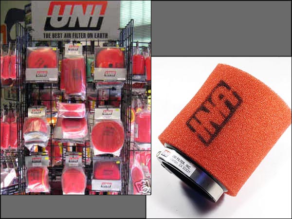

Any advice on an airfilter? I see some OEM ones on Ebay but wasn't sure if there wasn't an easier way. I don't necessarily need it to be back to stock at this point.

I would put a foam Uni universal filter on it. You can get them at most any motorcycle shop. Uni has been putting their displays and universal filters in every motorcycle shop in the world. Look for em. You can put their universal filters on anything. I got one on my big BCS rototiller and it looks awesome, custom style haha. You don't see the filters anyhow and the foam ones are MUCH better than anything else.
Check out their massive application guide: http://www.unifilter.com/online%20catalog/universal.html

Still, adding the air filter was the final step in making it run just about as perfectly as I could have hoped for. Without the air-filter I still get the occasional miss.
