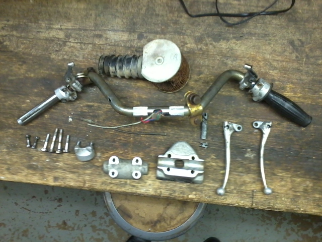

started on the handle bars, cables were cut, rewired and cleaned up the aluminum...

the handle bars.... rewire, clean polish

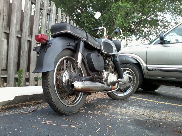

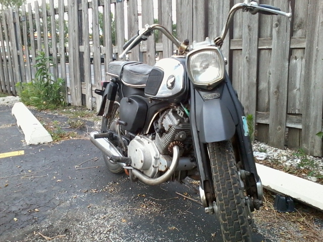

dont like the flat black at all... looking forward to sandblasting and paint!
Actually you have a CA160....not a CA95
The CA160 is the same frame but has a more robust engine. So when your buying a wire harness and engine parts, make sure it's for a CA160. I actually like the CA160 best IMO
Yep, CA160 for sure, and the Honda winged tank badges are flying in reverse, so they need to be swapped to the opposite sides of the tank.
Nice bike with plenty of potential.

break/clutch handles cleaned up really nice.kinda hard to see but the one on the left is polished....
You should be able to buy plug wire at any parts store . They should have 7mm solid wire on a roll , you'll need about 3 ft. On the coil side you'll see the leads go into the coil , you'll have to remove the clamp and pull the wires out . The new wire just pushes . I use a small amount of Automotive RTV to seal out the moisture and then reinstall the clamp . Reuse your spark plug terminals in the same manner . If yours are cracked or broken most any motorcycle shop will have new NGK terminals in stock .
You don't want resistor type SP wire or the resistor NGK spark plug terminals .
