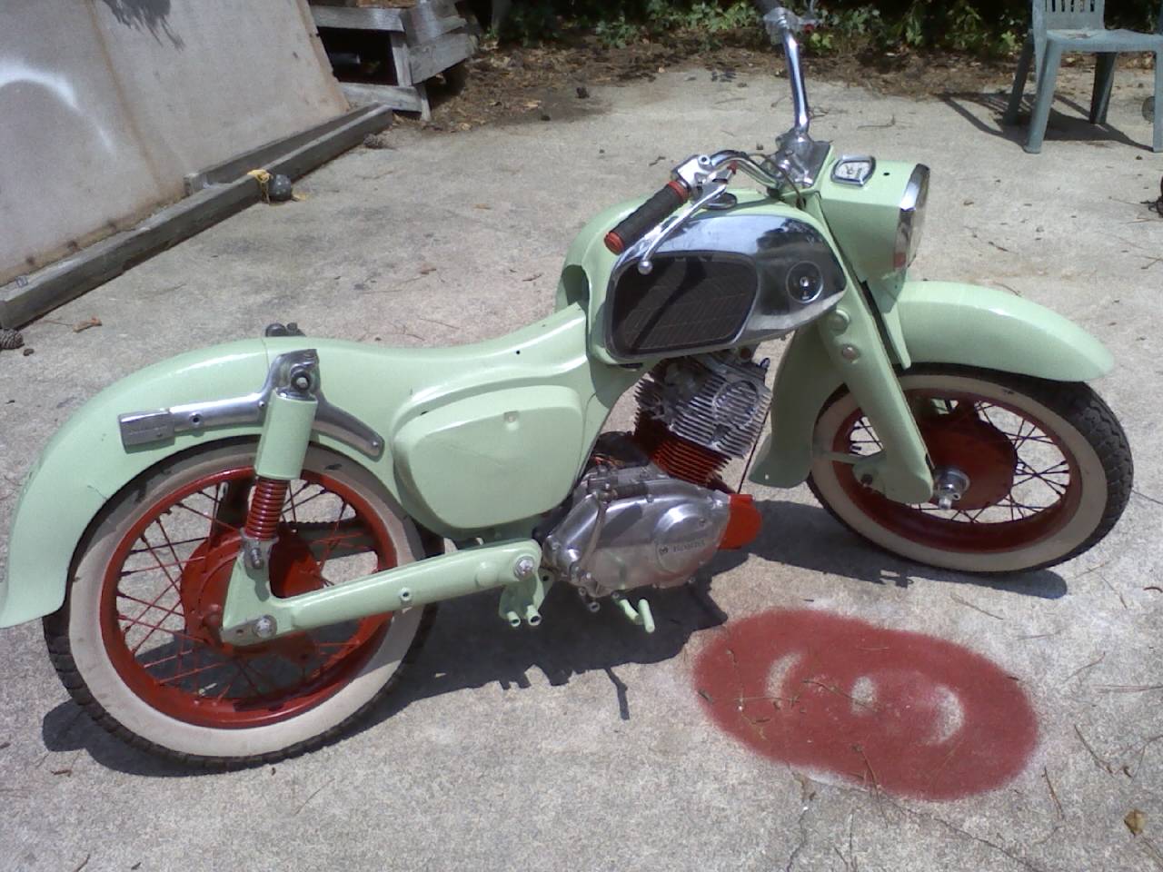

I am getting closer to completion on my 63'. I thought I'd give a partial list of whats been done and whats left.
1. Painted rims and body as well as painted the tires(whitewall), polished then lightly painted head with aluminum chrome.
2. cleaned carb, petcock.
3. ported, polished and shaved several thousandths off the head, valve job, balanced the crank. Polished all aluminum parts.
Whats left...
!. Exhaust
2. Coat inside the tank
3. Install wiring and convert from 6 volt to 12 volt system, add blinkers, and other wiring customizations.
4. Have ignition keys cut
5. custom seat made
6.. register and insure

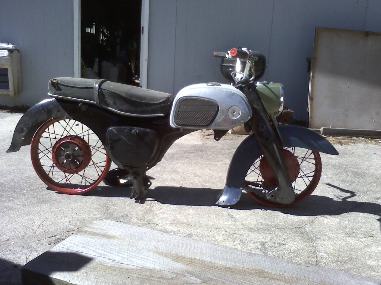

The first picture is roughly what I started with.
The second is where I am at on it now as of today May 31st.

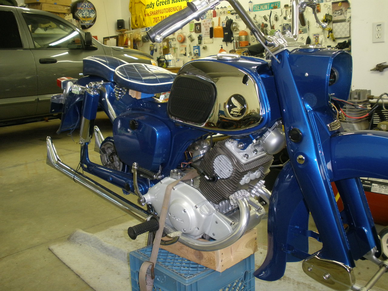

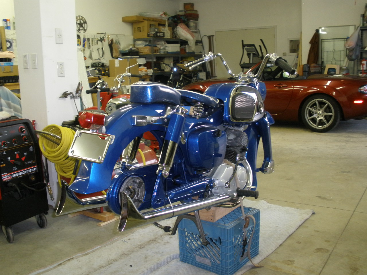

Here are several pic's of my blue bike with Santee Fishtails mocked up . The pipes are 1.75" dia. ,straight pipes ,no mufflers. I'll finish the mounts once I get my wheels back from Buchanan .

Ah that color combo is awesome and good to see something quite different. Exhaust is a very important element of the bikes styling for sure. I was messing around with a set of the exhaust bends that have the flanges on them yesterday thinking of what I should do with them. Fun stuff.
