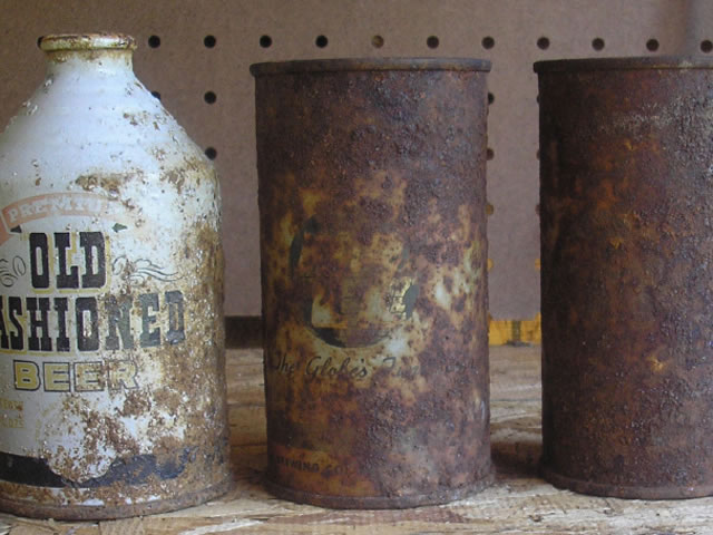

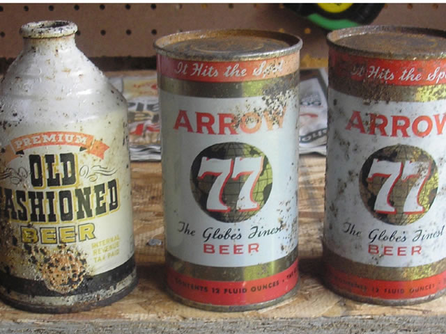

Theres a picture of restored metal beer cans using the stuff, that looks impossible enough to call Bull#$^@, I often wonder about companies that use some T&A to sell stuff, after all guys don't go to Hooters for their amazing frozen processed chicken wings lol, if it worked for you cool, however thanks to those beer can photos I am pretty skeptical now.
Before and after photos I am on about included...

Basically this product is a neutralized acid with a polymer additive. The acid starts at a pH of 6.04 and after it reacts it raises to 6.5 or so. (7.0 being neutral) The polymer in the product attaches itself to the free iron oxide in solution and forms into a sludge like material. That's why the girlies can put their hands in it. I know for a fact that it will dry the skin to cracking, so they were washing their hands as soon as the camera stopped. I buy hundreds of gallons of the same material for a production process that rusts cast iron and needs to be derusted. This science is only a few years old.
