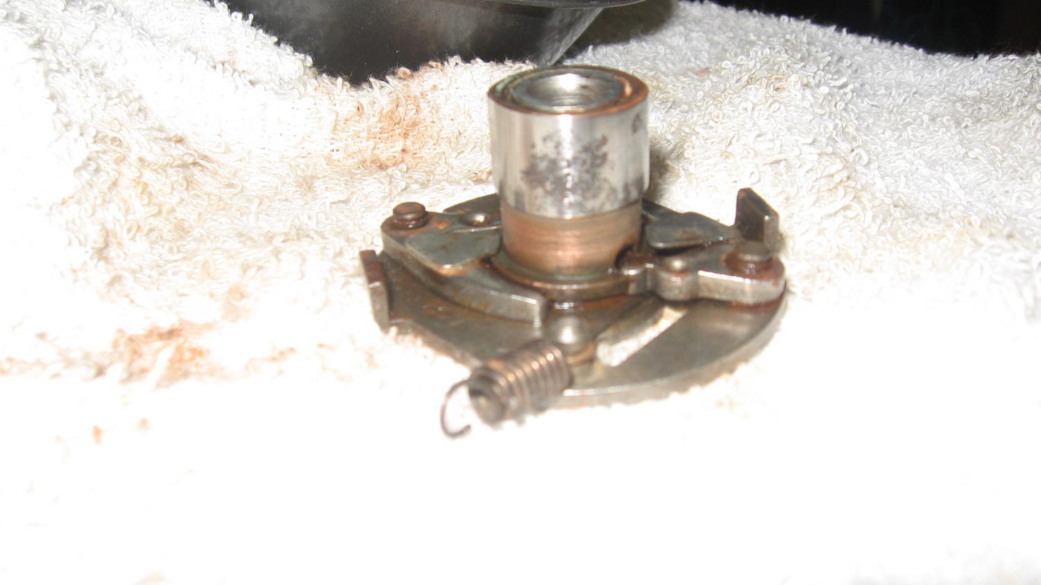

Should I be able to turn the advance mech. by hand- maybe with the springs loose? Does the points cam turn on the base? I've carefully removed the circlips and small washers on the weights and can't remove the weights to disassemble and clean the joint. Also the points cam was rusted in places, I cleaned it and went over it with 600 grit sandpaper and 0000 steel wool. It's pitted in places, surely this won't effect operation. See pic.

Points advance mech.
