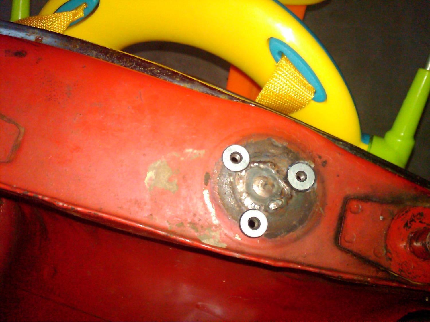

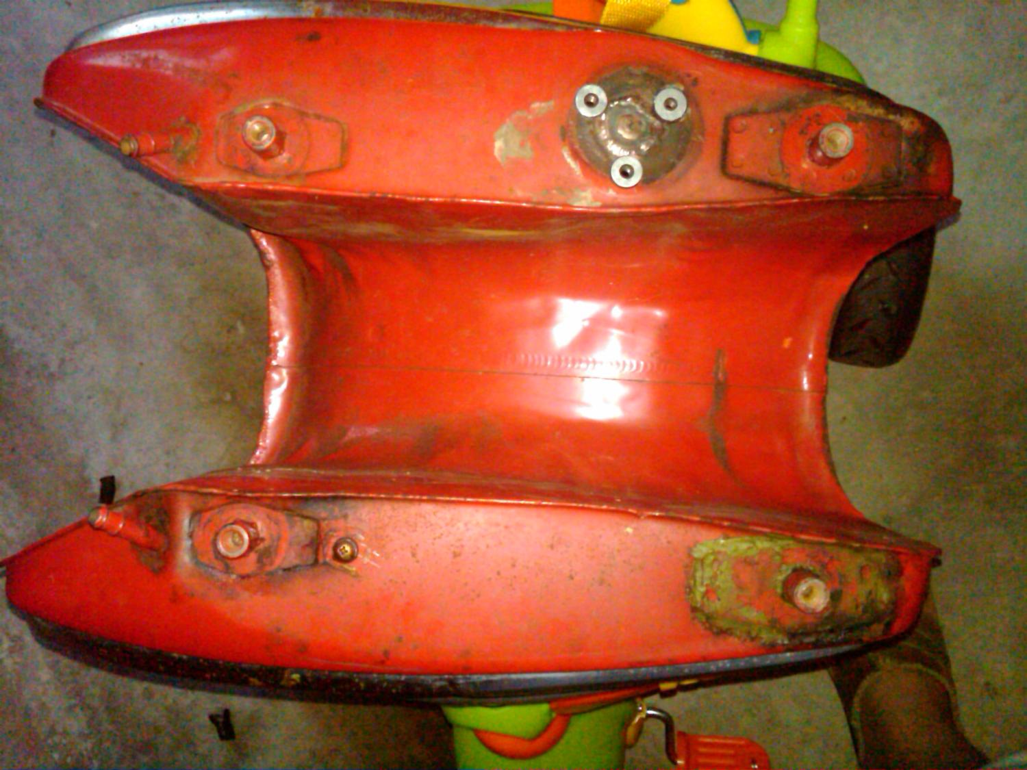

Ok, Spokes, here's the deal. I learned two things about my tank while doing the "rust treatment". Again, mind the Blackberry pictures. My wife and I are trying to figure out how to cashflow replacing our busted one.
1) What's missing in the first picture?
2) There's a pinhole leak in the rear of the tank. Any ideas on how to patch it? I've never done anything like that, so I'm up for any ideas.
I will say, however, that Meguiar's Chrome Cleaner and some hot water worked wonders. The BB's destroyed the only rust bubble I could find, then MCC did the rest.
I know now why the previous owner wasn't using the petcock.

What's missing is the petcock assembly. The pics show that the tank is in bad shape.The sealant around the rear mounts, the screw in the bottom of the tank, the newly found pin holes and of course the patched petcock opening.
Don't be too discouraged as finding an old gas tank that has been repaired over the years is pretty common.
Your choices are:
1.)Source a 1964-1966 CA95 tank or a 1966-1969 CA160 tank off of ebay.
Make sure that the tank offered has the 4 mounting posts. Somewhere around 1965 the CA95 tanks went to 4 post mounting, some 1965 & earlier have 2 posts and two front "C" mounts. These tanks you can't use unless you modify them as I did (you can see the pics in my album "Building a Honda CA95 from scratch)
2.) You can try some tank coating products that will seal the leaks. I hope some members who read this response chime in to let us know how the sealant works. The sealant may work well as long as the tank is clean and dry. http://cgi.ebay.com/ebaymotors/Gas-Tank ... ccessories
If you go the sealant route, you will have to use the same tube feed as the previous owner....
I would source a good tank...$65-$120.00 ebay.

Thanks for all the info. I checked ebay, and there doesn't seem to be anything up for sale right now, although I'll keep my eye on it.
I have a co-worker that mentioned he has done some motorcycle tank welding in the past, so I might have him try to chase the leak. What are your thoughts on this?
At the end of the day, if I have to route the fuel through the front two "spouts", I guess it won't kill me. I'd like it to be original, but free is good, too.
Thanks again for the help, guys. I might try the Kreem sometime, too.
Hmmm I have a spare tank that is in decent form but I haven't tested it for leaks. It needs to be rinsed clean. It has the four posts configuration but is missing one of them as they are barely tack welded on.
I just wouldn't put faith in any sealer. A friend of mine in the 4wd restoration business tried some sealer on a tank in one of his Jeeps and the sealer failed after a couple weeks and it completely gummed up his fuel system! So I run when I see that stuff on the shelves. Welding motorcycle tanks is easy with the steel in the old Honda tanks. Anyone should be able to weld up any leak in one of these for beer money.
About rust I've seen people use some pretty nasty tanks. They just put one or two of those clear fuel filters in the fuel line and that has been good enough for them. :)

Fair enough. The Meguiars cleared up most of the rust on the interior at least that I could see. I might still put an inline fuel filter.
My coworker also mentioned that he was thinking about welding the four mounts in place. Does anyone see any issue with that? I don't, other than making sure it's a clean weld.
Those mounts are just waiting to fall off. Weld those suckers up nice and clean. It will give him good practice moving around in a circle too. :-)
