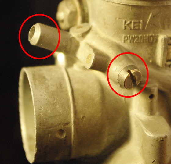

I need a #130 power air jet. I have the power jet, but there is no power air jet in the carb at all

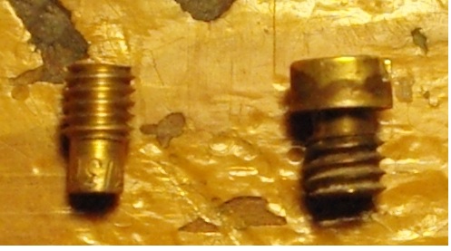

Here's the difference between the jets used in the "Power Air Jet" system, vs. normal sized jets. According to the service manual, there are two of these in the system, equally matched as a #130. I've also included a picture showing where you access these jets from.
