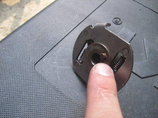

In your case 62, you need to make sure that, when you fitted the points cam/advance assembly onto the rotor, did the peg on the back of it locate into the slotted keyway. If it didn't, then the ignition will be all over the place.
Another thing to check, as Ryan (smithers) said in his link, make sure the advance and retard unit is free and not sticking open, it needs to be closed to set up the timing. Do this and check back.

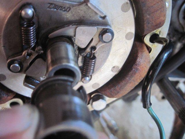

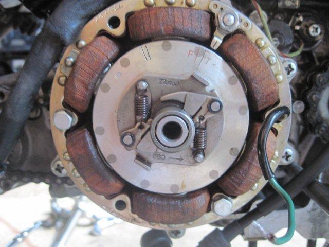

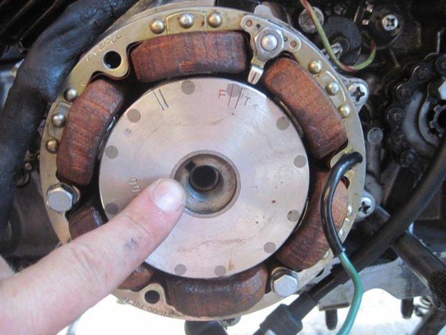

Ok so I checked the spark advancer peg and made sure it was on there correctly, and it was. I took some pictures.
I could rotate the ovalish rotor (Cam) 180 Degrees. Im thinking I'll try this. I took some pictures so you know what Im talking about.

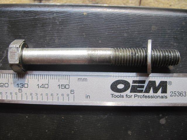

Also, I have a concern about the rotor bolt Im using. Its a little bit bent. Im hoping it would straighten out when screwed in all the way, or even better, its no problem at all. I took a picture of that too.

I am sure rotating the cam 180 Degrees did the trick. Now I just have to get the poor old guy to start up peacefully. Whew!!! This is exciting.
