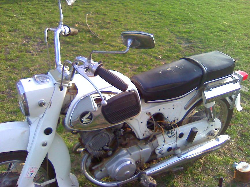

My name is Thomas, I am 20 years old and from a small town in Nebraska. I am working on a 1966 Honda CA95 that I got from my dad. I hasn't been run for about 4+ years now and I want to get it going again. I tried starting it today after cleaning the carb and changing the fuel in the tank and it just wont start. I checked for spark and nothing, so I did some reading on the forum here and read about the coil when it over heats a waxy substance comes out of it. I tore into the bike and noticed a waxy substance on the outside of the coil. Also, when I hooked a 6 volt battery up to it, the starter engages without pushing the start button, it also turns over on all but 2 key positions. I have been looking high and low for parts and havn't found a good supplier of throttle and spedo cable, air filter, and ignition coil, any help with what might be wrong or where to find parts would be appreciated.

1st thing I would do is clean the points. Another forum member found that any oil on the points kills the spark.
2nd would be is check the coil with an OHM meter 2.0-3.0 would be ok (my opinion) but the wax indicates that it has overheated and may well be toast.
ebay often has coils for the ca95. They usually need new wire and spark plug caps, but sometimes can be used as is.
The starter engaging by itself means the starter button is jammed in and just needs to be cleaned. The other problem is the starter solinoid is rusted in the contact position. I would check the starter button 1st. It is rare that the solinoid would lock in the engaged position.
The key. 1st position up is ignition 2nd position up is ignition and lights There are more positions, but those two will get you going. You can download the manual for more info off the internet.

go to http://www.hondaminitrail.com and click on CT70 Oval. Go to part KO-78 order these NKG caps at $3.50 each. They are the perfect fit. If you want to go one step further, you can get 7mm solid core snowmobile wire from ebay, 3ft for about $5.50. When you get the coil, you will see what looks like a plastic type seal at the base of the spark plug wire. Break the seal and pull out the wire. Cut the new spark plug wire to lengh and insert the wire into the spike contacts in the coil. Reseal with automotive sealant and install your new plug caps. That's the mac-daddy job. I have done this to my coils, it works very nice and also looks great.
