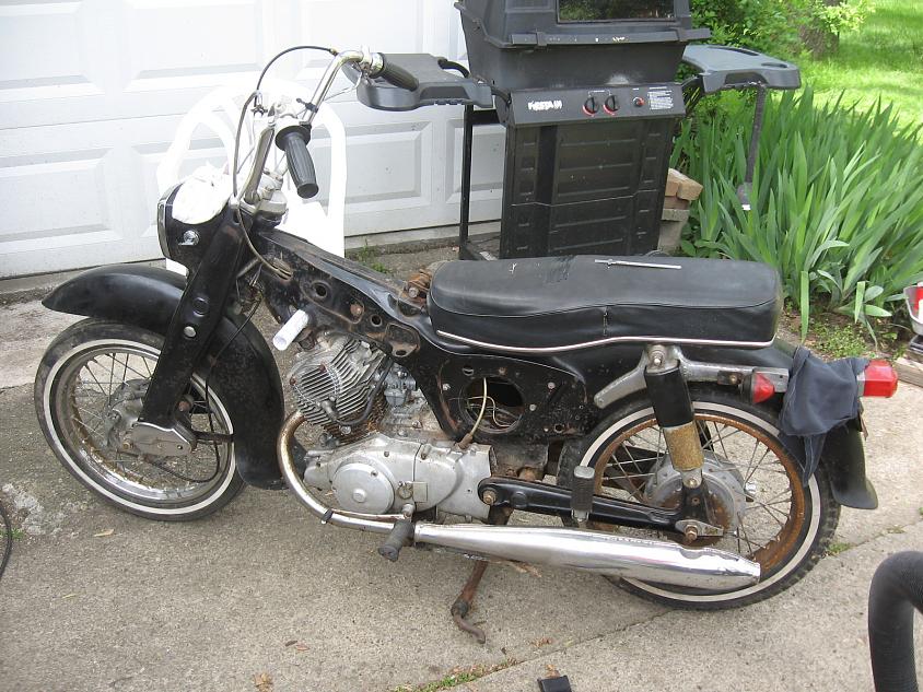

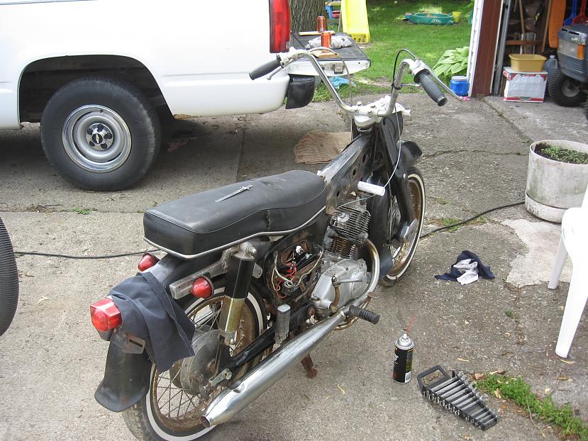

Last PA inspection sticker on the frame is from 1976. Finally after a slight derailment from a free riding mower I picked up a couple of weeks ago I finally mounted the carb that has been sitting in a box for the last few weeks. A few shots of ether and I have short runs until it runs out of ether. Tons of cardboard came shooting out of the one pipe. Is that bad? Looks like a mouse made a home in there sometime in the last few years. Hope he doesn;t have plans to move back in. Even seemed to run pretty smoothly for the short time it ran. Still plan to replace the wires and caps though. Probably when I tear it down to paint.Next step is to make a hanging gas can out of a bottle and some hose. Then back to the tank to see if my soldering job worked on the pinholes.

Well, some success tonight. I didn't take any pictures of the redneck gas tank, but picture a 20oz coke bottle with a barb screwed into the bottom of it hanging from the handlebars. Didn't mess with the points other than running a card through them to clean them out a little - they looked pretty clean compared to the rest so I figured I would chance it. Added some gas to my bottle and got it started relatively easy. Idle wasn't bad, but most acceleration seemed to pop and backfire. More adjustments and I shut it down for a bit to go eat dinner. Pulled the plugs after a bit to clean and check gap as well. More gas and more noise for a while and acceleration seems to have cleaned up. Now I need to free up some brakes and put the chain back on. Pulled the oil drain plug to let it drain and called it a night. Old oil sure does stink...

Well, tonight I freed up the front brake cable and the spindle on the rear brake lever so I now have brakes. Starts and runs pretty decent now so I put the old chain that I had previously cleaned up nice on it and managed to get a lap around the yard before it broke. I knew the stress cracks in the chain were no good but I figured I could at least ride around the yard for a while before picking up a new one. I guess not... crap. At least the neighbor got some entertainment out of it.
