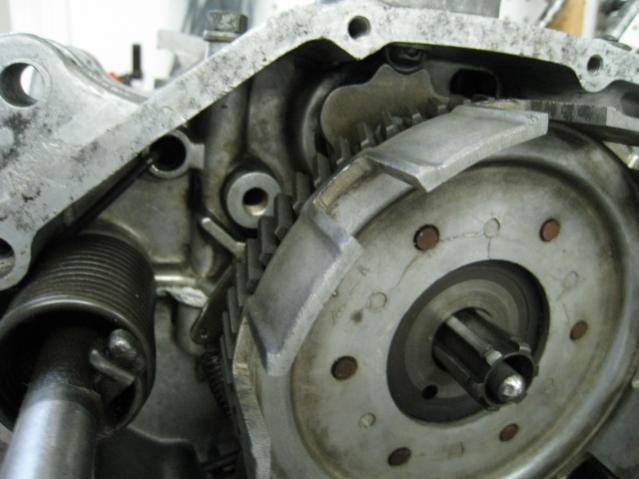

Is there a bolt that goes into the threaded hole behind the clutch basket gear?
Couldn't find anything in the manual and it's been a loooong time since I took it apart.

I think it was for a different king of gear selector drum stop. If you have the plunger style on top of the gearbox then it its unused. Check out page 48 of the manual and you will see a different type that pivots on a bolt at the place you have the threaded hole.

That clears that up. Thank you very much!
