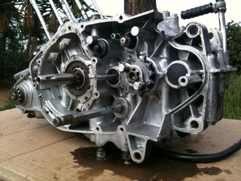

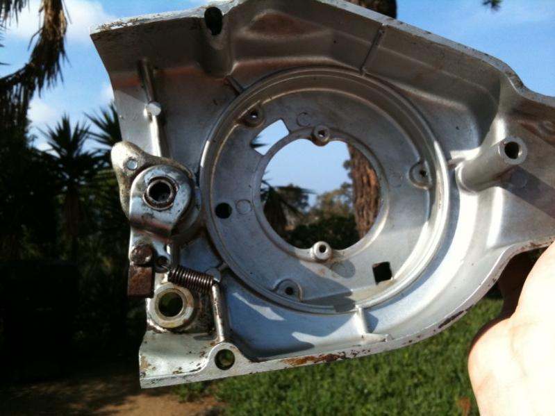

Based on the advice good advice from the forum members here I decided to clean up the motor real nice before reassembling it. I also wanted to bring the good, smooth clutch feel back.
I can NOT believe how much crap was in that clutch/cam lever assembly! I'm also surprised at the poor design of putting the clutch push rod an inch from the chain where it collects all the gross fling off...it was caked with junk.
So a couple hours with a Dremal with a brush adapter, a couple cans of engine degreaser and lots of paper towels I got it to this point today (I'll do a bit more tonight to make it perfect).
The cylinders are coming back this week (.25 over). The head will too. It was ultrasonically cleaned and pressure tested and it was fine with a light lapping.
Gotta find a good quality engine gasket set now (any ideas/leads?).

Talking gaskets should be fun. You should get alot of opinions. But here are mine, based on rebuilding the exact engine.
A set from an Asian source in the mid price range works. Pay less usually means thinner. I have one gasket that I have custom cut thicker, and that is the right side case gasket (clutch basket side) I have it made about twice as thick.
Another part of the gasket set is the "o" ring set for the rocker covers, and a tiny "o"ring that fits in the engine head. The ones you will get will leak after a short while.
Replace all of the "o" rings with an exact set of VITON "o" rings. They cost me $3.50 ea. But keep their seal under heat.
I actually have a set for that engine, but they are my "copy" set and custom cut would be 3 times as expensive as the asian ones. (4 times including the viton rings)
Don't forget the engine oil seals. Remember what you saw when degreasing the clutch parts? Well the same grime wears out the engine seals. Buy the seals from the Honda dealer. They are 91206-200-000 clutch push rod seal +91204-200-00 Shift fork seal and sprocket seal 91202-200-000
Don't forget to get these seals as well: 91305-202-010 + 91201-201-000 and 91207-201-010 (all of these numbers will be superseded) These seals are found in your flywheel stator housing and starter sprocket. Very important, it keeps oil out of your stator housing.
Additional advice will comes in, there are alot of quality seal materials that you apply from a tube. If you go this route, always follow instructions exactly.
Last but not least, make sure the head gasket has a metal ring around the bores.
Oh, use a nice synthetic grease in your clutch mechanism. I use aircraft grease.....but that's way overboard.
One more suggestion.
Since the engine will be refreshed and riding the bike around town is the goal, you may want to take advantage of this time with the engine removed..to check your front and rear wheel bearings.
Both front and back bearings most likely have old and hard grease. This will wear out the bearings fast and cause the bike to wobble.
It would be well worth the effort to get new wheel bearing seals, clean the bearings and relube them. When your ready (should you want to do this part) let me know. I have a mechanics "trick" to remove the wheel bearings from these old Honda wheel hubs. Maybe I will start a thread on this procedure....
You also have 4 rubber dampeners that the resr sprocket hub fits into. These are most likely dry if original. Replacing them would be a good thing to do.
