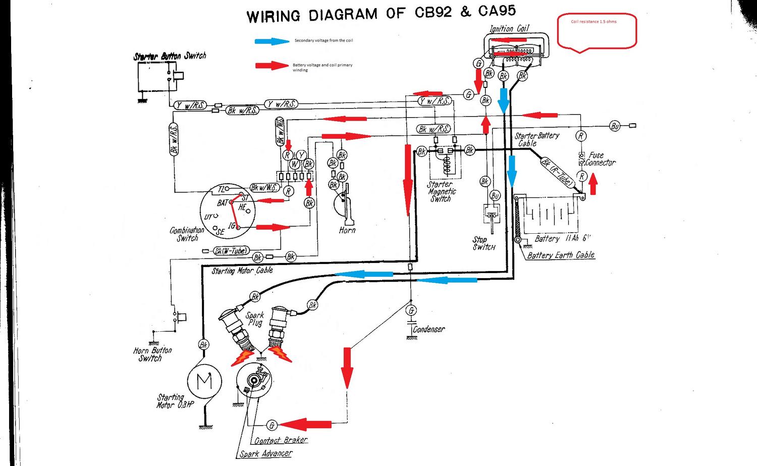

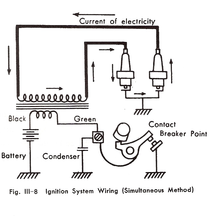

I don't know if this will help but- I've always found it useful to have a map of what I'm looking at. For electrical stuff it's called a wiring diagram or schematic. Most manuals have one but because we are not used to this particular kind of map it becomes easy to get confused, crossed up or whatever. I've tried to cut out some of the extra stuff in the following diagram. For this discussion we are just trying to get spark so I removed the clutter of other circuits we don't need right now (rectifiers, dynamos, lights etc). Even now the diagram is still a bit cluttered but we can begin to see the circuit that pertains to us. To be more clear I've added a red arrow to indicate the path of the circuit for the ignition. The blue indicates the voltage generated by the coil going to the plugs.
One thing I need to point out-Honda uses a technique called "switched ground". Essentially we can think of the circuit (after the combination switch) as energized but with no place to go until it finds a ground. This is what happens when we apply either the starter button or the horn button. We are suppling a path to ground (not power) to complete the circuit rather than applying power to complete the circuit-
This is one reason ground connection on these bikes are critical.
I'd have to say if there is continuity throughout the circuit then it follows that the electrons have a path to follow. In this case the path to ground is through the condenser and points. If you establish continuity between the points body and the backing plate (indicating the points are grounded) then I'd suspect the condenser is blown. Looking at the bottom half of the second diagram the electrons only have a limited place to go to get to ground. I hope this helps-
