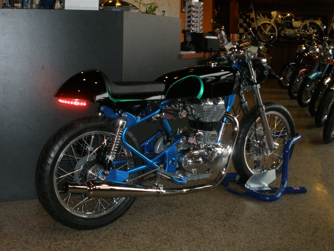

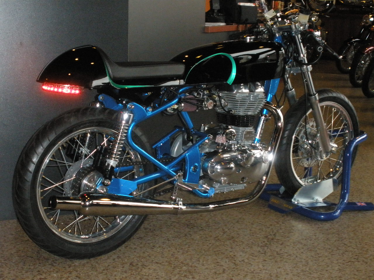

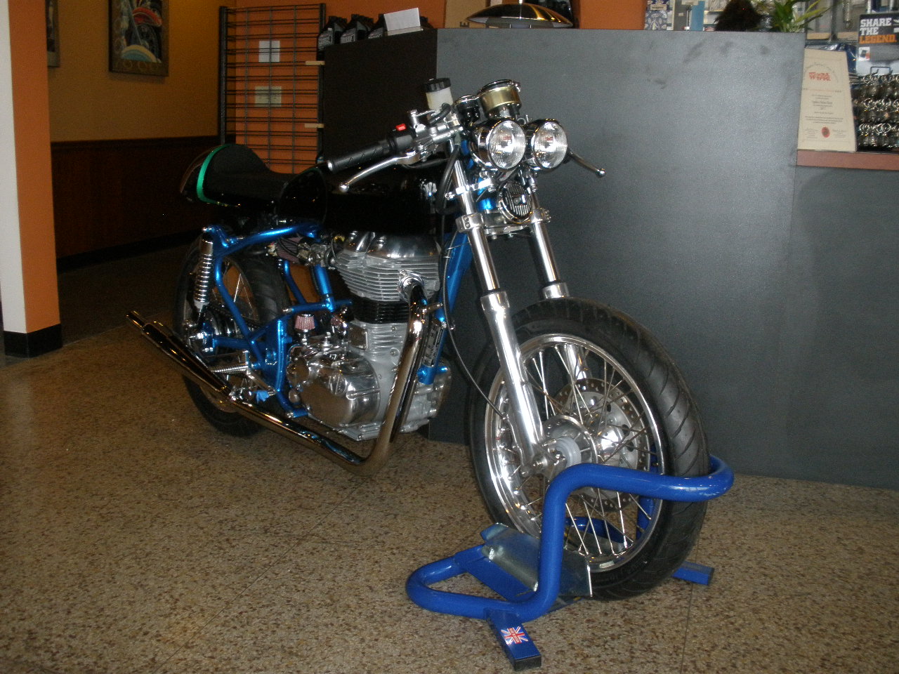

Here's a 2011 ( brand new ) Royal Enfield that was totally stripped down and remade into a cafe racer . This bike is georgous in person and has a ton of custom billet alum. machine work, triple trees , dash pod , engine mounts rear brake backing plate , rear sets .
These bikes are fuel injected so a seperate fuel pump and regulator had to be installed . Omar's for the tank and seat . Shouldered alum. Akront rims and SS spokes added to the stock hubs . All unnecessary tabs removed from the frame . Front suspension is stock but clip-on bars added .
All work was performed at Spike's Vintage Motorcycle Shop . My contribution , I made an alum. cover for the speedometer !! Yeah I know , WOW .
I read about the Royal Enfield new bikes in the magazines last year and I just wanted one so bad. I still do but my garage capacity says no. Making a cafe style bike out of one just never crossed my mind but heck if the owner wants something different he sure got it!! The fuel tank sure made the bike. Good job on that custom cover! haha

Smithers , if you really want it just send Spikes Vintage Motorsports 16 grand ! The Royal Enfield importer talked several dealers into taking new Enfields and making them over into cafe bike and then show them at a New York motorcycle show this past Feburary . Only problem was the importer didn't want to shell out any money for the show space . He wanted the dealers to pay for everything , space , displays ,all the odds and ends that the shows promoter wants paid for . So, long story short , about a half dozen dealers built cafe bikes and weren't able to show them .
I've taken Spike's Enfield and shown it , several first places . Don't know if it will ever sell , he's got more in it than what he's asking .

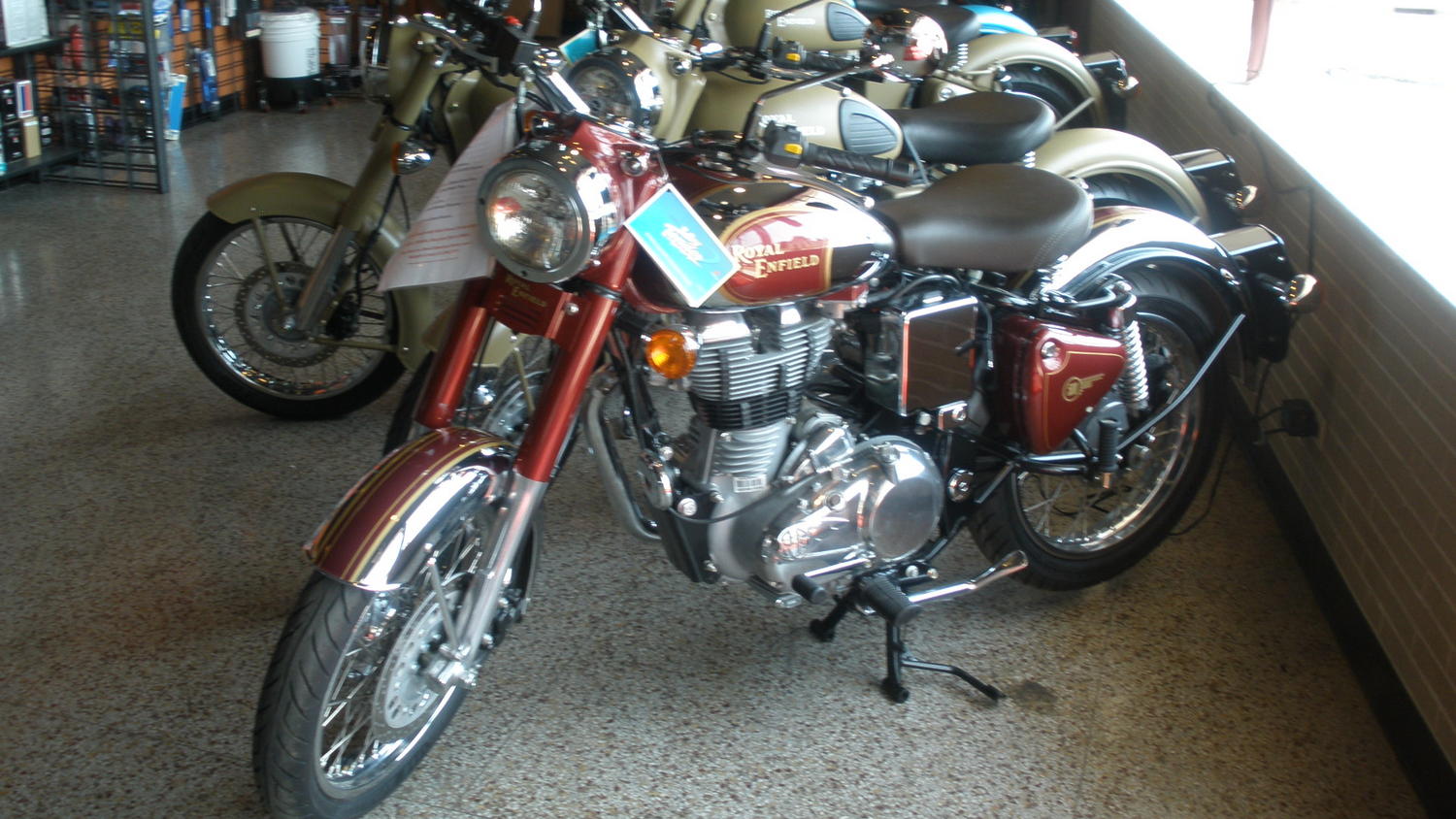

The new Royal Enfields are very close in styling to the older models but do have a new for 09 engine that combines the transmission but still has that retro look . They've also gone to fuel injection and electronic ignition so their very reliable . I've assembled 6 of these bikes from the shipping crate to the showroom floor for Mike and it's amusing as to what you find when prepping the bikes . Basically you have to check every nut and bolt for tightness as well as the wheel assemblies for trueness and spoke tightness .
The engine assemblies are well made but use a rudementry screen in the crankcase as a particle filter ( I mean BIG particles ) so oil changes should be on a more frequent basis . Also , for a 500cc single cylinder bike ,a little more HP would be a plus . They'll go about 80/85 mph. Good around town bike but not freeway inspiring .

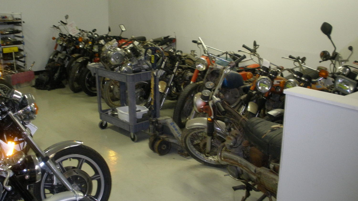

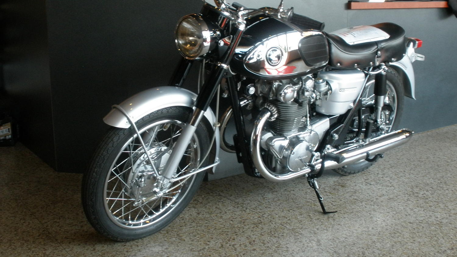

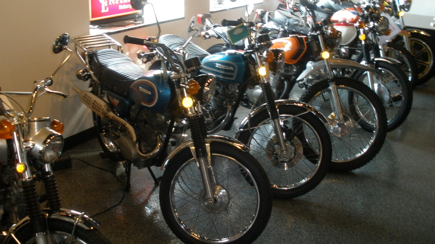

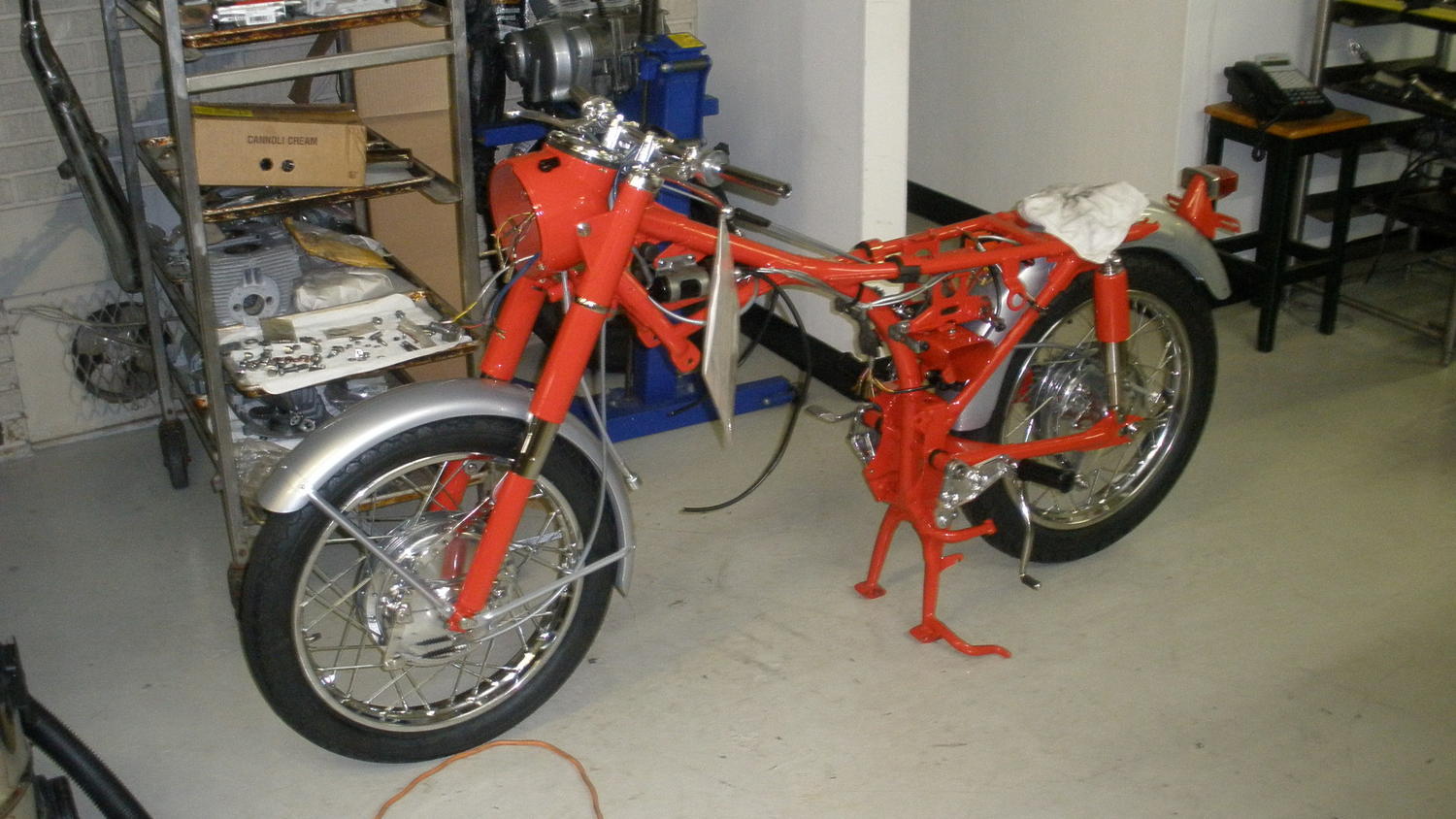

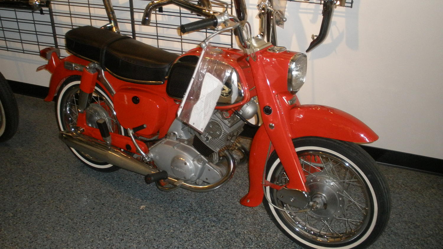

I've attached several pic's of bikes at Spikes . He has 80 to 90 early Hondas with a few Yamahas , Suzuki's , etc. Some are original , restored or ready to run as is or restore .
It looks like a museum in there! That's pretty cool. Glad to see a vintage friendly shop and people enjoying it.

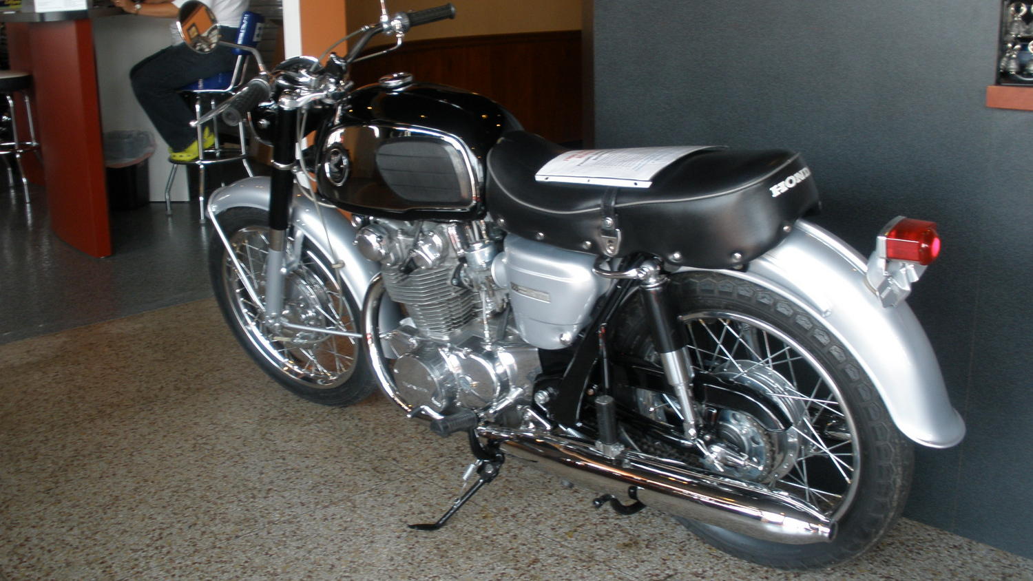

More pics , enjoy ! Early Hondas , this place is a candy store !
Guess I should figure out how to link to post a bunch of pictures at one time , sorry .
