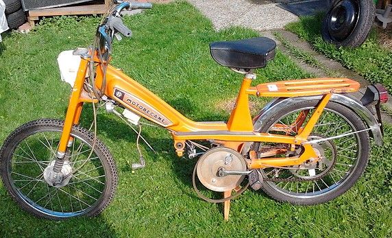

I'll pull the post if it's not allowed, but I thought I'd just check in with my latest project: a 1970 Motobecane Moped. I picked it up from an Army Vet that's moving back east.
The engine was seized (now disassembled in a box), but the jug is fused to the piston, and the crank is corroded.
I'm in the process of digging for a new engine, or enough parts, then I'm getting started on the rest.

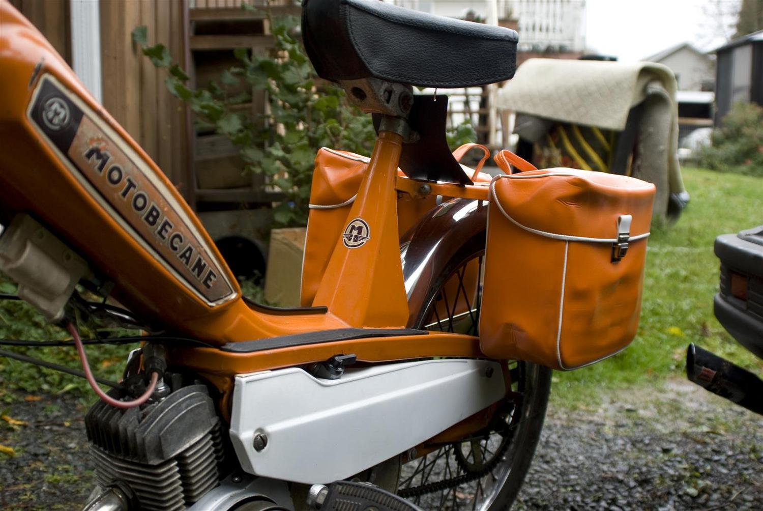

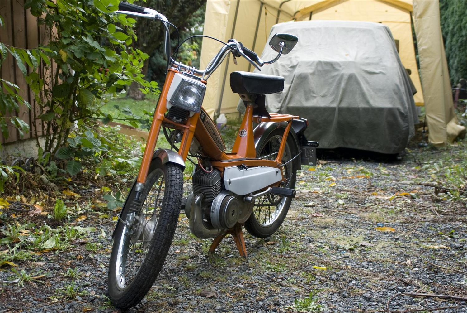

I thought I'd share how things went with the Motobecane, so here's how things went:
I found another Motobecane with an intact engine that sat since 1988 - so did a transplant. Other work:
  • Swapped clutch inner rotor
  • Converted to external condenser
  • New petcock
  • New carburetor (Dellorto SHA, instead of original Gurtner)
  • New rear wheel bearings
  • New drive chain
  • New rear brake plate
  • New control cables
  • Hand grips
  • Bar end mirrors.
  • New tires
  • Sandblasted and repainted sidecovers
  • Cogged drive belt
  • Rebuilt horn/headlamp switch
  • Swapped headlight bucket & speedo
  • NOS chrome gas cap
  • NOS 70s Saddlebags
  • NOS replacement headlamp
Flat out, it'll do around ~37mph on a good day, tucked in. I still need to get some new fork boots too...

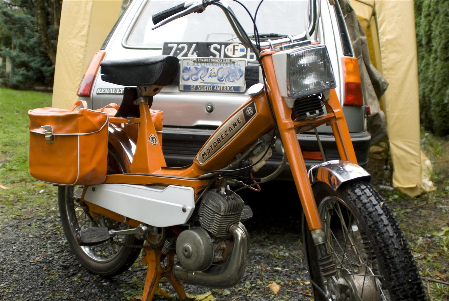

Haha, now I'm riding it around the countryside:
Running like a top, new rubber, changed the front wheel to an 80mm brake for improved stopping, new fork seals, et al.
